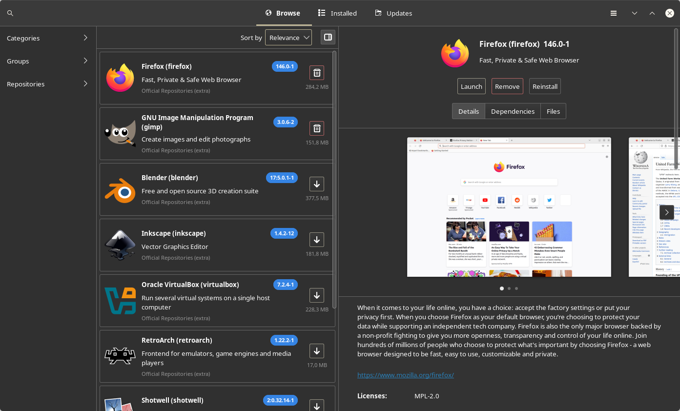

Overview
Pamac (Add/Remove Software) is Manjaro's Package Manager. It is based on libalpm with AUR and Appstream support. It focuses on providing an easy to use interface while still providing a powerful set of features.
Pamac GTK3 with package information sidebar
Installing Pamac
Pamac is pre-installed on many Manjaro Editions but if your system does not have it it can be easily installed. Pamac comes in several different packages:
  • pamac-gtk3 - A Package Manager based on libalpm with AUR and Appstream support (GTK3)
  • pamac-gtk - A Package Manager based on libalpm with AUR and Appstream support (GTK4)
  • pamac-cli - A CLI Package Manager based on libalpm with AUR support
  • pamac-tray-icon-plasma - Pamac tray icon for Plasma users
  • pamac-gnome-integration - Pamac GNOME integration
  • libpamac - Library for Pamac package manager based on libalpm
These packages can be installed using pacman. For example, to install the GTK4 version, you can use the command:
user $ sudo pacman -Syu pamac-gtk COPY TO CLIPBOARD
